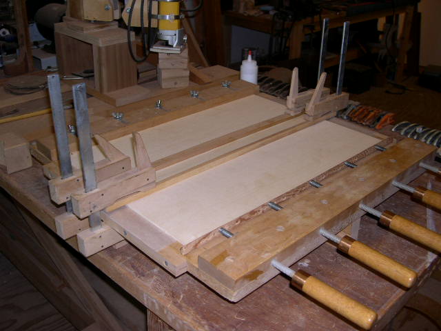

Well, after Joe's post, I'm a bit reluctant to post this, but I'll do so anyway.
Simple hardware stuff:
PostPosted: Mon Jan 30, 2006 6:39 am
Joined: Mon Jan 24, 2005 1:47 am
Posts: 117
Steve,
Anyone who listens to me is nutty than I am. I bet that jig works great. That's all that counts, right.

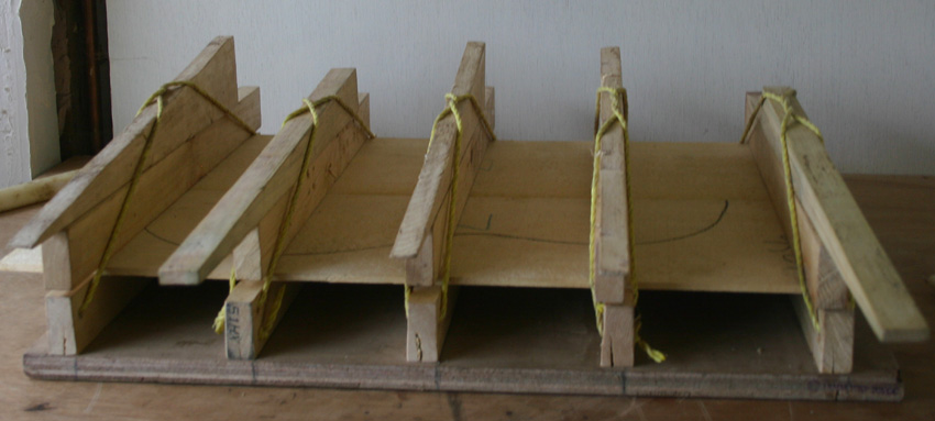

Another Alternative
PostPosted: Mon Jan 30, 2006 3:17 pm
Russ, your jig is how real luthiers do it.
Looks great...simple, effective, inexpensive.

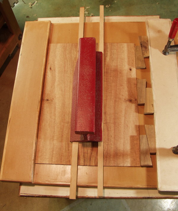

Here is a simple setup.
PostPosted: Mon Jan 30, 2006 9:40 pm
HI Steve
I can't claim that I invented this, I think the design came from a book by Jim Williams, an Australian Luthier.
PostPosted: Mon Jan 30, 2006 10:59 pm
Rob, now we know what caused that train derailment up in your area!
I have a chunk of that somewhere, great idea. Gotta love the little wedges, simple enough. I love this forum.
PostPosted: Mon Jan 30, 2006 11:12 pm
Rob, is that track segment Canadian ?
PostPosted: Tue Jan 31, 2006 12:40 am
I use the same set up as Rob (I leave whatever heavy object is nearby on there though, usually a jointer plane since I've just been jointing the plates!). It's the only method I've ever used as I made my first guitar the Cumpiano way.
